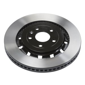

Ok, so they're non-vented rear rotors. Venting holes might actually help with cooling then. Obviously the rear brakes don't see as high of temperature gradient (shock loads). Thicker materials such as solid rotors can tend to crack more easily but with the lower heat gradient I think you would be safe. Try and add some chamfering to the vent holes if none are present. It helps to redirect the stresses around the holes rather than through the holes.
Nope. Vented front rotors. This is the original design. Vented hat along with the vented main rotor. The aftermarket PowerStop are solid along the hat (Ford has also superseded to this design).Wgb bd180535e ih xl
