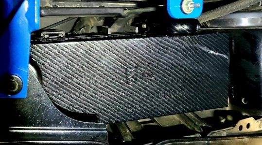

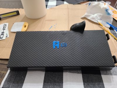

Well you would think that since I had my fuse box cover custom hydrodipped in carbon fiber I would be happy and be done with it, but no I had to mess with it some more. I went to hobby lobby and bought a tiny paint brush and hand painted the raised part of the lid. I think it came out alright and gives it a little color to the carbon fiber. I'll post a before and after picture.9f5f6ba5d4950f02d527f1fb83deb825Cf97dbd7aec4c4cad9823f76e69b91a1
Like I always say it's the little details that you will notice. Nice job
Where do I send my parts to have all this done? Lol
