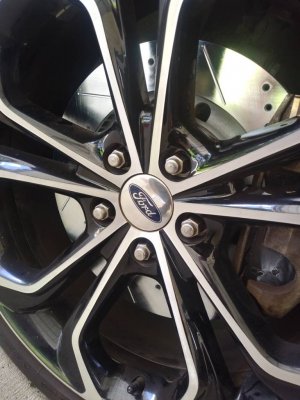

Installed the powerstop brake kit. New rotors and pads. Also did a fresh oil change after running a can of bg 44k through it. Oil only had 1900 on it. Pretty dark. Was pennzoil platinum before. E7097d764bdf27d74d4a092b294d6ebd
Sent from my LM-Q610(FGN) using Tapatalk
Should've painted the calipers while you were at it.
