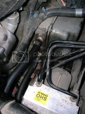

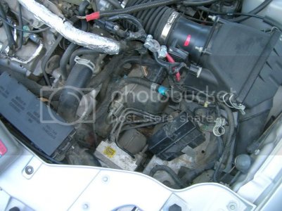

I don't beleive there is a VSS on the transmission. I've been wrong before...
ABS box, you ask and shall recieve!
NikonPhotos092 1
Mytrannylines
It's the SHO only box. Underneath the battery tray which is a total PITA.
