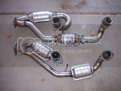

This is the best I can come up with that shows the difference between an equal length and a non equal length aftermarket SHO y pipe........... I dunno what type the non equal is....... its not stock however
notice how the equal length has a loop in it

...and the picture is worth 1000 words. Thank you! That is what I suspected, but the picture at SHO Source was not an equal length pipe, hence my confusion.
Thanks!!
