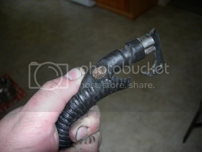

Well I found the problem. As I'm trying to pull the starter I see that the bracket that's supposed to hold the positive cable to the starter is bent to the side and not bolted in place. Right up against the bracket is the cable. I slide the plastic guard to the side and find my cable nicely eaten through to the wiring about 1/4 of the way. I bent the bracket back and returned the plastic guard and tried to start the car and had the same results.
I will replace the positive battery cable, and I might as well replace the starter while I'm already in there. That starter is a PITA to remove! I fought and fought with the bottom bolt and it's on so tight, it's trying to round off. I sprayed it with liquid wrench. I have no clue how I'm going to get that 10mm bolt at the top of the starter off. I quit for the night b/c I don't feel like screwing with it anymore tonight.

Here's the problem.
Batterycable
Actually was the negative cable from the starter to the solenoid. Someone replaced the starter before me and lost the bolt to that back bracket; it was bent to the side and rubbing against the cable. Since I was in there already, I'm going to go ahead and replace the starter with my spare, as well as a new cable. I had to use my long ass torque wrench to get enough leverage to get that 13mm bolt out next to the tranny. Holy **** it was on tight!

Tape it up good and put it back in. If that's the only damage then I don't see why electrical tape won't work. That and the loom should do just fine.
If you really want to replace it then do as suggested and list a WTB ad but you are still taking a risk that those cables are in good working condition. At least with the one you have, you know what's wrong with it.

You could go to a electrical supply store and get rubber tape to wrap around that spot then elelctric tape over that. Also in the future take your car parts to a electric repair shop for testing. I don't trust autozone or advance.

agrred that doesnt look like it rubbed through the copper to much if you have some extra heater hose laying around cut a small piece in half and wrap it over it and tape the **** out of it

Yeah I'll just tape it up, throw in this new starter, reconnect everything and try it again. I'll finish it this weekend. I have to work out of town for a couple of days this week; didn't feel like messing with it anymore today. I'll give an update on whether that fixed it or not once it's back together. Thanks for all the help everyone. It's because of this forum that I'm able to learn to work on my own car and fix it. Never thought I could do some of the stuff I've done. SHOs will make you a mechanic.

Put it back together today. I taped up the damaged wire, installed the new starter, and it works great. I guess the bad wire shorted out the old starter and burnt it up. Now my tach is stuck under the peg from when the instrument cluster went nuts with the old starter in. I took it out and ran it to high rpms in 1st and 2nd but it didn't jump over the peg. I don't feel like tearing the instrument cluster apart now.
