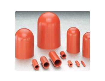

1" High Temp cap source
I found a source for 1" High Temp Silicone Caps. Problem isn't price per piece ($1.63 ea.), it's that the minimum order is 10 plus $6.35 s/h (You'll pay $22.65 delivered for only needing 2 of the 10 caps). Only comes in rust color. 1" Diameter by 1.5" long. They also offer a 4" long version (likely the one pictured below). They are used for the powder coating industry, so they are good up to 600F.
https://store.mocap.com/mocap_en/msc.html?Item=MSC.980-1.5
Another source, but the design is domed and shipping is $10 for 5 pieces....
http://www.stockcap.com/store/1.000-x-1.500-FEO-Red-Silicone-Cap-5-Bag.html
Silicone rubber caps
