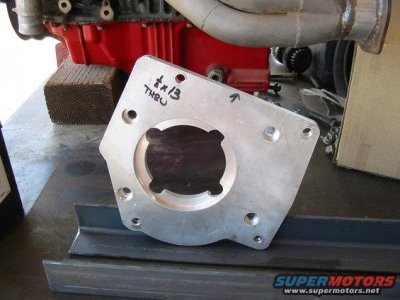

For all you guys that have been buying the pilot bushings and bearings from me over the past couple of years, I am having machined the adaptors that allow you to bolt the Aerostar bell housing to the Borg Warner T-5. Just in case you're wanting to get the motor aligned North/South, like God intended.
Here it is:
Img 0030

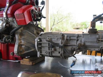

And this is how it looks all together:
Img 0195
I will only have 5 for sale and it will be "first to paypal, first served". If you want the adaptor only, the cost is 206.00 Plus shipping.
If you want the bolts, nuts, studs, washers and the little tube of LocTite to anchor the studs with, the cost will be 247.00 plus shipping. The bolts are all hardware store available grade 5 bolts, and I make the studs from grade 5 bolts also.
The adaptors will be arriving from the machine shop on the 14th, test fitted to my T-5 and Aerostar bell housing on the 15th and ready to ship after that.

And here they are! All have been test fitted onto my AeroStar bell housing and my Borg Warner T-5 model 1352- 238
[/IMG]
Two are sold so there are 3 left for sale.
