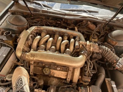

Guys, hello everyone! The car stalls when hot, the tachometer needle stops working, traction disappears and shakes the whole car. Sometimes it evens out. throttle body hasn't changed.If it stalls, you won’t start it anymore, it starts shooting from the pipe, grabs it, and immediately stalls, only when you push it can grab it.After some time, compression in one cylinder disappeared.changed the engine control unit, dis,throttle sensor. Nothing helped.I think that the camshaft sensor makes brains, maybe he carries himself like that? Thanks in advance.

The cam sensor is a good bet if the engine is still turning and you get a 0 tach reading, as it would on an MTX that is in gear and decelerating. However, ignition cutting out, failing when hot can also be the exact symptom of crank position sensor.

I understand, thank you, there is a spare crankshaft sensor, I will throw it up, you also need to look at the cylinder, damn it
