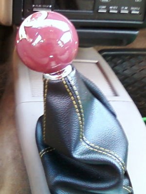

You can always get hold of a Cue Ball(your choice of design) and, with a drill press, set up your own shift ****. This is how I did mine:
0404111634a
very nice, yeah that would be probably my best choice other than shosource. I liked the ones they had there. Just seen those last night
