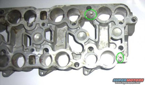

SHOZ123
Dec 2, 2000
12,152
673
Illinois
There are two holes on the bottom too where there were a steel balls inserted. Both on the passenger side.
Im bottom whit highlites of holes that need filled

Some jb weld on the four holes and its all good then. The holes in the middle don't affect the way the air flows?
