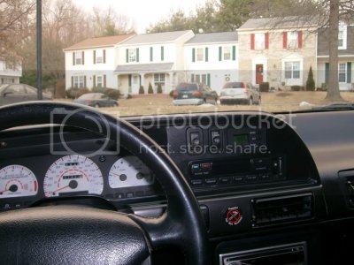

Me and Whiteguy3 just finished the whole faceplate conversion.
everything works except the lights, we used a 94 soft button as the donor.
for reference, this soft button had the lighting style with the separate plate for lights.
anyone know how to make them work?

It looks sweet. We just need to get the lights behind the buttons to work. The lights behind the fan work.

here ya go. lights started working yesterday. guess they just had a bad connection.

im sorry but im going to have to do this to you. this unit does not fit in the sho.
if you see a round button unit with the vent button right next to Max a/c it is the smaller faceplate style which leaves about an inch gap on either side of it. this unit also doesnt fit into the slot for the eatc it has to be modded alittle bit.
im not saying it cant work. im sayin that even after you put all the soft button wiring into it you will still have a faceplate that doesnt fit the dash.
again, im sorry im bad mouthing your for sale ad.

thankyou, and yeah i didnt know either. whiteguy3 and i picked up the very same unit that you had and put it together just like this one to put in his car and realized they made two sizes.
but if you notice my buttons say max a/c norm a/c and then vent. when you press norm a/c in my unit it would go to vent, because it is supposed to. so i took the buttons out of the unit that you have and swapped them around alittle bit.
its really awesome now. :nut:

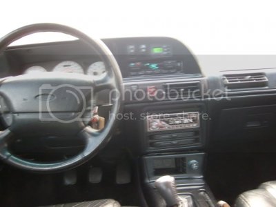

Rockledge
Pluggin' away
Sep 5, 2003
1,914
32
Connecticut
I bought this one a few years ago off another member here, Mike Gallion, vis a vis eBay.:
