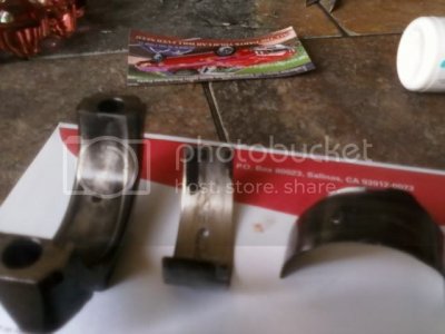

Got the bearings out...
Here they are. None of them were spun or worn through. It looks like all the rod journals on the crank are nice and smooth, no scoring of any kind. I pulled them all first (trying to find the culprit to the knocking,never found it), kept them in order as I pulled them out, so all the caps/nuts go back on the same rod. Thinking I probably won't plasti-gauge any of them, being that the journals look as good as they do.
While I am glad that none were spun, I am a little confused as to what caused the clacking. Would anyone have anything on this?
All bearings showing copper.
Cross-hatching still looks pretty good.
A little concerned here, looks like oil seepage down the cylinder wall from above the piston. Not sure if that is what that is or a burn or stain of burnt oil.

on the crank journals, run your fingernail across them (front to back) and make sure you do not feel any ridges. they need to feel smooth to your fingernail.
on the cross-hatching - you can see in your photos how far down the rings move when the piston is down - what the cross-hatching looks like above that point is what you care about.
on the oil leaking down (?) past the one piston - it is likely that the ring gap in the bottom oil control ring happens to be located there. if that is the case, nothing to worry about. if not, there is a good chance that at least one of the rings is stuck (very common on these engines) in which case it would be a good idea to pull the heads, pull the pistons, and soak them in parts cleaner solvent to loosen them before you put it all back together.
on the clacking noise - these engines have lots of other things moving that can sound a lot like a rod knock, including loose timing belt and loose timing chains. another reason to at least pull the valve covers off to see what it looks like under there.

I bit into the copper, but it all looks good to me. Fresh bearings and on your way.
Most people misdiagnose top end noises as rod bearings. Cam chains and tensioners are terrible at transferring noise all kinds of places...
