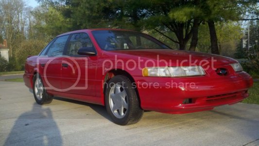

Restoring a 1993 MTX

Color Sanding
Now that the car is home, I began color sanding and buffing. I started with 1000 grit paper that i soaked in a bucket of warm slightly soapy water for an hour. I wrapped it around a thin rubber sanding block and had at it. I did one panel at a time. When i was done with the 1000 i moved to 1500. I learned about a new product called Trizact discs. They are very expensive at $87.00 for a box of 15 but they are amazing. They are a thin foam backed 6 inch disc used on a DA. I used 3000 grit and wet sanded with them as a final step. I then pulled the disc from the DA and used it by hand to get into the areas the DA can't get into. I followed this up with white 3M rubbing compound on a black foam pad, then a blue glaze on a yellow pad. The parts I have completed look excellent. No scratches, dirt nibs, orange peel or swirls. I think it looks too good actually.

Cars have come a long way since 1993 and this car validates that statement with a capital V. It drives very well for what it is. I got out nearly all of the rattles and squeaks. I did all of the recommended services, so it has all of the power it should. On the highway it’s enjoyable and relaxed, but around town, the MTX is a thing of horror. First gear is too steep and the clutch is obviously too small. The steering is slow and the brakes are merely OK. It has to be driven hard to accelerate quickly. This car is not terribly heavy, and the engine isn’t overly powerful so I expected it to be good on gas, but it just isn’t. What have I done?
Macgyver
Jul 21, 2012
70
26
New Jersey
Oh well, 16 mpg or not, I'm in deep so I may as well follow through. I sourced a hard button EATC for $75, and got it installed. I also replaced both rear calipers and hoses. Rear brakes make a huge difference. The rear calipers were completely frozen and non functional. I also replaced the valve cover gaskets and did plugs and wires along with a fuel filter. There is very little else to do other than drive it. The A/C is ice cold and it drives well. I have since renamed my other car the Millenium Falcon, because that's how it feels when I drive it after driving the SHO.
