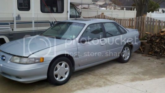

Here is a pic of it when I got it.
Here is a shot cleaned up after the ice melted:

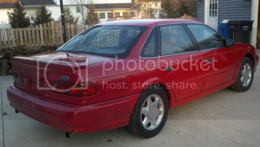

I searched for quite a while before I purchased this car. It didn't come cheap, but it is an excellent starting point. Here is a better shot of it.

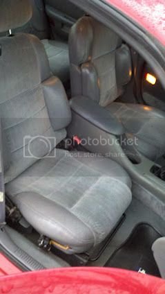

This car cost me $300. I took the passenger upholstery from it an put it on the drivers seat of my car. I had hoped to use it for more, but this car was pretty rough. I managed to sell it for $500. Here are some shots of the seat being done.
2012 02 11 12 31 39 410
2012 02 11 12 31 30 559
2012 01 21 16 26 37 897

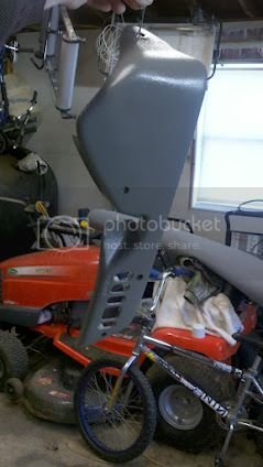

You can see in the last image there are no valances on the seats. I found it very difficult to find gray valances that weren't smashed to bits. I found a 95 Taurus in a boneyard that had a mocha Bucket seat/console interior. The seats were SHO style, so I grabbed both valances and repainted them.
2012 02 26 09 12 01 742
I used Ford gray engine paint after I cleaned and thorougly prepped them. The final appearance is fantastic. These late model valances have more ribbing in them. I think they'll hold up nicely.

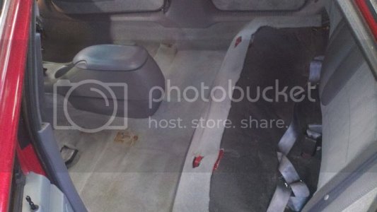

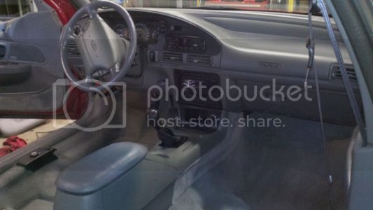

While the seats were out I had a chance to really clean everything inside. I pulled out the carpet and cleaned it. I actually disassembled almost the entire interior because I needed to re-do the headliner. Here are some pix:
2012 02 26 09 12 16 153

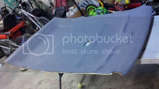

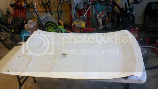

The original headliner never sagged, but was at the point that if it was touched it would turn to dust. I've never seen one do that. When I went to remove the foam from the backing, it was still stuck to it very firmly. I got it all off, but damaged the shell in the process. I tried to locate another shell, but had little luck. I decided to try to fix the one I have. Once all of the foam was removed, I painted it with Kilz primer to "tighten" it back up. After I let it dry, it seemed pretty sound. I applied the new headliner as usual and so far it seems OK.
2012 02 28 21 19 26 724
Here are some shots of the interior during the cleaning process:
2012 02 12 16 18 41 193
2012 02 12 16 18 13 646
2012 02 12 16 18 00 991
I don't have any shots of the interior completely disassembled. These show it nearly done with just the seats needing to go back. It will all be coming back out as I plan to move forward with new paint work and floor repairs.

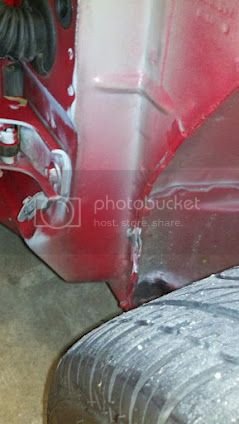

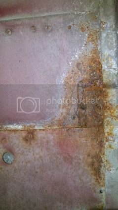

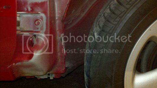

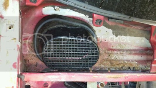

Speaking of floor repair here are some shots of the only rust I found in the car:
2012 03 19 20 01 34 476 1
I noticed that when I power washed the cowl vent area, this area was getting wet from the inside. I know many Tauruses do this, I've seen newer ones that are much worse. Is there a problem with the HVAC drain? I'd like some advice here. I got a small section of roof panel from an 03 Tahoe that I plan to patch this area with. The driver side has it too, but to a lesser extent.
2012 03 19 20 01 14 131 1

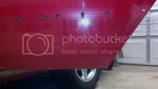

The rest of the car is positively rust free. here are some shots of key areas:
2012 07 23 20 43 12 20
2012 07 22 11 30 08 806
2012 07 23 20 43 03 149
2012 07 22 20 22 31 645
2012 07 22 20 22 55 286

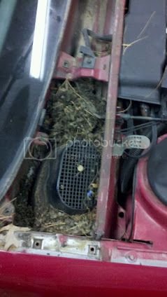

There is some minor clean up in here due to some critters building a nest:
2012 07 21 20 35 20 284
2012 07 22 20 57 52 16
2012 07 23 20 43 30 5

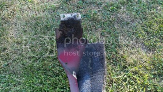

Behind the fenders were full of junk too:
2012 07 22 18 07 12 362
2012 07 22 18 07 39 139
...but everything cleaned up well with no damage.
2012 07 22 20 23 32 989
This car must have sat for quite a while to have the amount of nests it had in it.

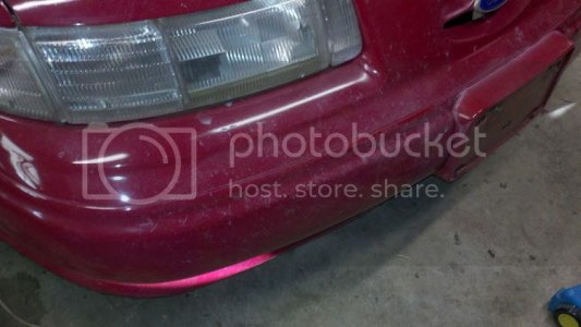

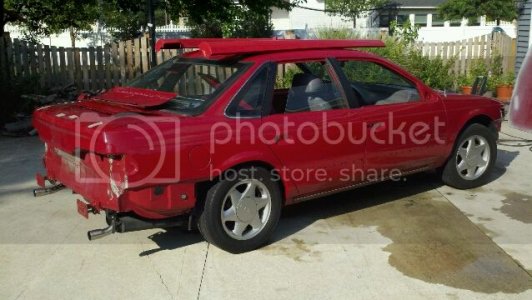

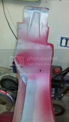

I need to get some shots of the bumper covers. I have them cleaned up and nearly ready for paint. Here is a before shot of the front cover:
2012 02 12 16 19 54 172
Here are some shots during disassembly:
2012 07 22 11 27 50 1812012 07 22 17 32 07 155

Lookin' good man. Not sure how to tackle that rust...I wonder if it even needs to be patched? Hard to tell.

Looks like you need a hard-button EATC.

I do need a hard button EATC. It's on the agenda. I called some local yards looking for a headliner, but most around me only have 96 and up cars. I didn't look too long after I thought of this method to repair the board.

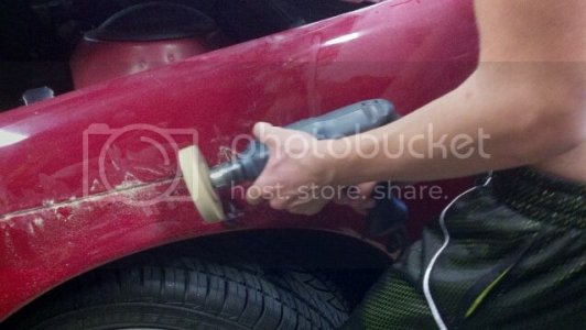

The car hasn't been painted yet. It looks OK in the pictures, but all of the top surfaces look purple and the clear is lifting off. There are some dings I'm going to fix in the doors too. I'm going to need to do something with the floors. The passenger side is bulging up under the sound deadener due to the rust. I'll take some pix and post them soon. Rust never sleeps and since I'm putting all of this effort into this car I'm gonna make it right. My 14 year old son is getting in on the action, so that is what is motivating me to take my time and do it right. I can see us taking it to car shows and displaying it in the unloved cars section.
Here he is running the pin stripe eraser.
2012 07 21 18 37 44 39
2012 07 21 18 37 55 63

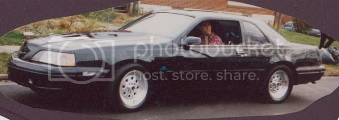

Years ago I had an 88 turbo coupe that only had slight mods to the body but had a nasty 2.3 turbo in it. I love the stock look with performance mods. Here's my old TC:
88tcoupe
The only body mods were stripe delete, body side moulding delete, the draglites, and custom but small blue Ford Motorsport decals.
