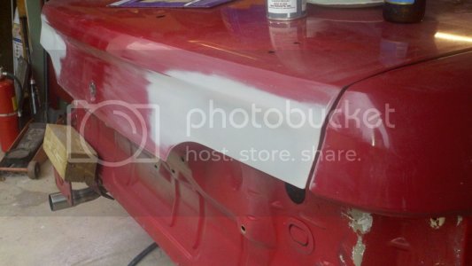

I was finally able to steal a few hours this weekend to make some progress on the SHO. Vacations, sports practice, work and the V needing motor mounts ate up a months worth of time and funds.

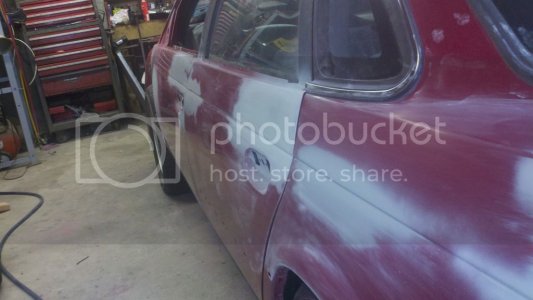

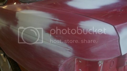

My focus right now is to make all of the panels straight. I plan to put a nice basecoat/clearcoat finish on the car, so taking my time now will pay off when it gets painted. The car is surprisingly straight with minor dings and scratches needing attention. The passenger rear door is the worst and took most of my time. Interestingly, the passenger front door needs almost no work.
2012 09 03 14 25 12 715
2012 09 03 16 34 26 452

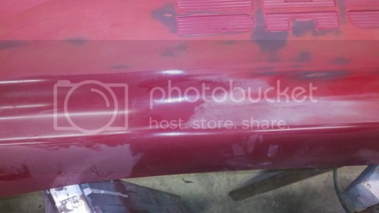

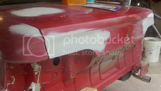

The only modification I plan to make to the body is the elimination of the badges. This required filling the holes in the decklid. I don't have any pictures of the disaster, but I attempted to weld one of the holes shut with my stick welder and made a pea size hole. I knew better, but I tried anyway and failed. My solution at this point was to clean up the hole and move forward. I slightly dimpled the holes and filled them with Quicksteel 2 part epoxy. Once it hardened, I ground it flat and put a light amount of evercoat on top of it and blocked it out. I then hit it with a high build primer and blocked it 2 more times. The result is perfect and should look excellent when painted. The beautiful thing about this is that if I decide to put the emblems back on all I have to do is remove the posts and carefully apply them in the stock locations. I think I'm going to like the clean, debadged look though.
2012 09 03 16 34 41 444
2012 09 03 16 34 32 562
Here are some shots of the drivers side progress too:
2012 09 03 16 34 55 440
2012 09 03 16 34 47 69

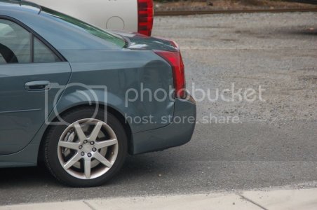

Just had another setback. My other car took a shot from a school bus yesterday. It was parked and got backed into. I'll need to get this sorted out first.

Eww. Through the crease, and I'm sure there's a spot welded seam behind that bumper and taillight.

Argh! On BOTH counts! Can the dent be pulled out?
I'm not sure yet how we'll do it. The guy who hit the car with the bus is actually our Lead Tech/Body Shop Manager; the bus was in for a mechanical repair. He was very upset about it and is the one who will be doing the repair. I was never upset about it. Things happen. It's just a car and nobody was hurt.
He originally said he'd like to replace the quarter, but I expressed that I'd prefer to repair what is there. Either way there will be a small amount of filler. It'll either be in the area of the dent, or up on the C pillar and rocker. I'd prefer repairing what is there in order not to cut up the car and compromise the factory corrosion protection. Believe it or not, the bumper cover is hardly damaged. Nothing broke on it. I ordered a new tail lamp and a bumper side bracket, but as far as parts are concerned, that should be it. On a brighter note, there is a ding in the passenger door that happened when the car was days old. It had 900 miles on it when it happened. That will also be fixed as well as a fresh coat of paint on the wheels. The shop is taking care of me in the best possible way.
It's ugly, but completely repairable. Our shop is filled with real craftsmen. I have no worries that it'll be done right and with minimal filler. I'll post pix of the repair, or post a link to them. I may actually get some time on the SHO this weekend.

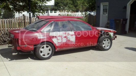

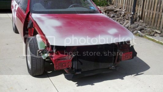

Progress Update!
It's a beautiful day here, so I thought I'd pull the SHO out and take a few shots of the progress.
2012 09 16 14 52 06 553
2012 09 16 14 52 14 67
2012 09 16 14 52 24 758
2012 09 16 14 52 34 608
The Maxima in the background is the shop "shuttle" that I get to drive while the V is being repaired.
I plan to get out in the garage tonight to remove the quarter windows and finish the passenger rear door. I have a new long sanding block on order. I hope to see it on Tuesday. At that point I hope to be able to prime the whole car with high build primer and block it all out. I did a side job on an very rusty Isuzu Rodeo that will pay for all of the materials to paint the SHO. I plan to use Wanda for the basecoat to save a bit if $, but I'm torn on the clearcoat. I'll let you know what I decide to do.

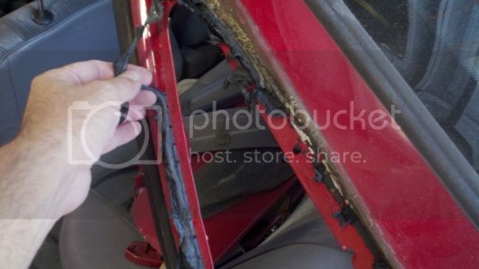

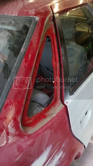

I got to it sooner that I had hoped to. The quarter windows were simple to remove. I pulled the interior panels, removed the nuts and carefully pushed and pried the windows out.
2012 09 16 17 01 40 626
I was very pleased to see that the quarter windows are held in with 4 bolts each.
2012 09 16 18 03 48 975
Once out the adhesive was easy to peel off the body and windows themselves.
2012 09 16 16 48 35 678

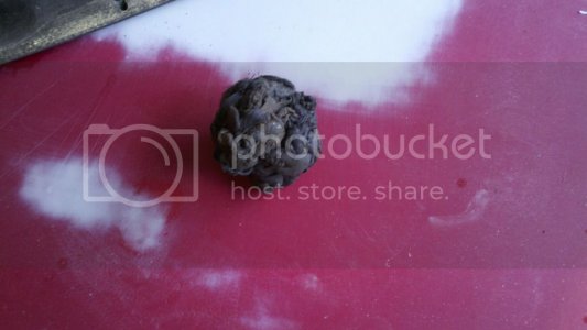

I was left with this blob of window sealer.
2012 09 16 16 50 00 338

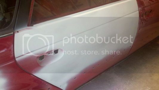

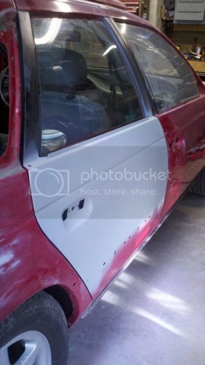

Back to the actual body work. As I mentioned before, the passenger rear door was the worst part on the body. It looked like it was hit lightly at one time and someone got inside the door and pushed most of the damage out. Ordinarily when I'm at work I'd try to find a clean replacement door. Since these are getting harder to come by and also since my car is so clean I decided to straighten it. A replacement door would have likely required as much work anyway. This was my second go-around on this door. The first time I primed it, I wasn't happy with the results. I block sanded the door, skimmed a few areas lightly and got it perfect. Here is the result in primer:
2012 09 16 17 09 57 434

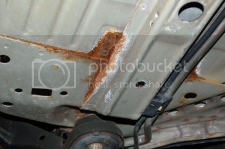

I guess I don't feel so bad about my floors anymore...
We happened to have an 07 Taurus in the shop today, so for giggles I put it up on a lift and had a poke around. Here is what I found. I know they all do this, but I was concerned mine was bad. It is not.
Here's a shot of mine:
93SHOFLOOR zps7429bebf
here is a shot of the 07:
O7TAURUSFLOOR zps9b8308e5
I still plan to get into it to stop any further progress, but I feel better that a much newer car is in nearly the condition mine is.

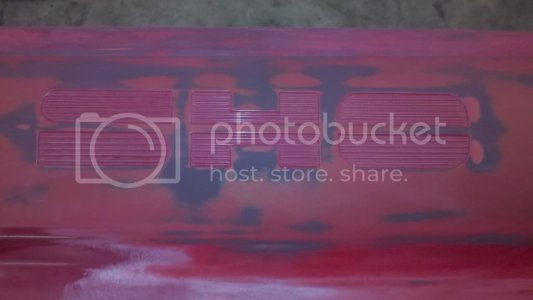

Since the clear coat was beginning to lift I had to remove it from the covers. I used a DA sander and 220 grit followed by 600 grit and finally scotchbrite to ensure there are no sanding scratches in the final product.
2012 10 07 19 38 05 667
I used scotchbrite to clean and scuff the lettering. I don't want to have any paint adhesion issues in these areas.
2012 10 07 19 38 13 986
You can see how discolored the clear coat got. The car looked purple on many areas.
