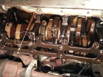

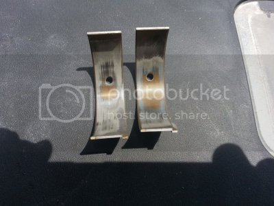

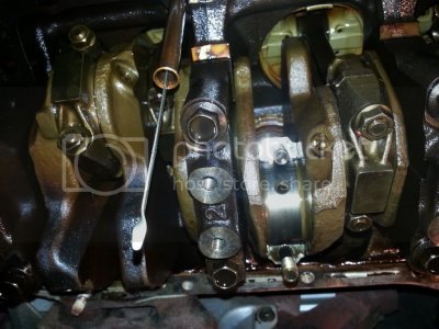

Rod Bearings
I decided to do the rod bearings before I put too many miles on it. It had the telltale 1 second start up clatter, so I knew it was time. Everything went perfectly. I griped a bit about RCM, but they came through with everything I needed at a very fair price.
The old bearings were worn to the copper, but nothing was scored or beat up in any way.
