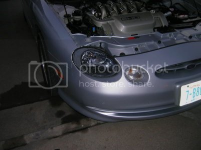

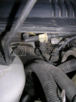

Your looking at the small little black cap in the middle of the picture
ScannedPhotos018
And another shot
ScannedPhotos019
Hope that helps, and this is on my 99

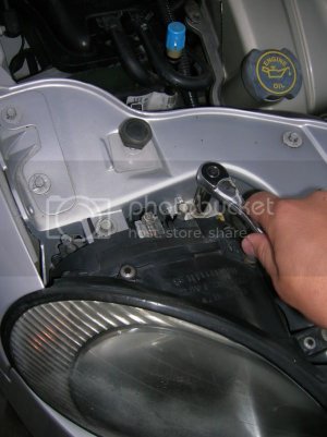

ScannedPhotos017
ScannedPhotos015
The blue cap is the other side of the AC for reference

After looking at Paul's pics I just remembered I forgot to put the dust cap back on... :rofl:
