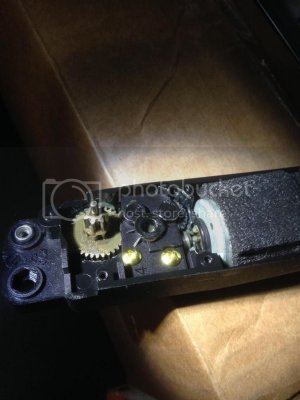

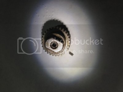

Already ahead of you. Took the motor apart and as expected, one broken tooth on the big gear. What i found interesting is that the gear is in fact metal and i THOUGHT i remember someone posting they had replaced the gear before but I am not sure. I am unsure of what tells this thing to stop but I would imagine that repeated abuse in the stopping position eventually chipped the tooth. However it it is possible that the tooth chipped and then it was never able to achieve its closed position and that is what caused the clicking.

Yikes, that's pretty wild. That appears to be a rather specialized gear, not something that you'd be able to source from McMaster-Carr or similar unfortunately.

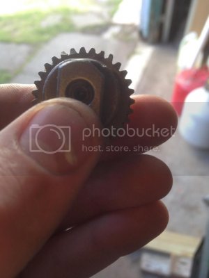

I fixed it. I mig welded the tooth back on (that was realllllllly fun, let me tell ya), filed it down to as close as I could get it. Put it all together and it works like a charm. The teeth are by no means perfect but I just couldn't put the stupid thing back in without attempting to repair the tooth first.

That's good for a pat on the back and a bit of an ego trip. Hopefully that ends up being a long term fix.

haha nope, used a small miller mig welder. I actually found it wasier to weld the tooth to another exiting tooth, they tack the edges with really low heat. After that one done, I took the dremel and cut the teeth back into two separate teeth. I verified the gears mated together well enough to grip and threw it all back together. So far so good!
