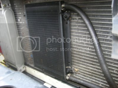

Hey, Sam. Care to share how that's set up? Where did you run the lines and mount the pump?

I'll get pictures this weekend. I owe like 3 people pictures of a particular setup on my car. :nut:
-Sam
Sam feel free to post one in here if you want I too am interested in how this was done on our MTX

But Since I'm such a nice guy.... I half took my bumper off to get some pics, It was easier then crawling under the car.
Here's the Line to the Cooler:
IMG 7032
Going in to the Cooler:
IMG 7028
And out to the Pump:
IMG 7030
I don't exactly remember where exactly the Return line from the pump, to the trans goes to. It's cold and wet outside so I don't want to go under the car to get pics, Maybe Bob can Chime in on that.
It's activated by the fog-lamp switch.
-Sam

My cooler was tapped from the front of the bottom of the tranny and returned into the fill plug.
