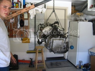

Wow, the inside of that motor looks pretty bad. Are you going to reuse the heads with the rebuilt short block?
As I said earlier the main wiring harness disconnects from the one that goes through the valley. The rest of the main harness sort of wraps around the engine bay - disconnect all of it and drap it over the drivers side fender. The p/s lines and cooler once disconnected from the tranny can also be pulled back and layed over the area of the master cylinder to get it out of the way.
I used 3 chains to pull mine. Two crosshatched over the motor and one to connect those two to the hoist.
I bought bolts and hooks to install on each corner of the heads.....and I used my crappy valve covers to install the motor as I didn't want my good ones damaged by the chains....
I'll post some pics of my install to make it a bit easier to understand what i'm saying....
The first pic is ready to go back in, the second is right after it came out. Enjoy.
