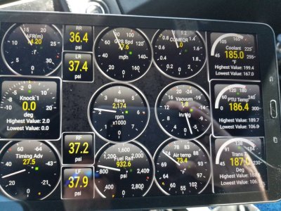

Assuming that I've entered the right PID and formula in Torque Pro, is 170-185 degrees normal for PTU temperature during normal driving?
Seems about right, 185 for a few hundred miles almost constantAssuming that I've entered the right PID and formula in Torque Pro, is 170-185 degrees normal for PDU temperature during normal driving?
I used PID 22070d and the formula ((signed(A)*256)+B)*(9/8)+320)/10What PID did you use?

I guess I should have looked at your readings when I copied your torque pro layout!
Using a cheap Samsung Tab-E and a OBDLINK MX adapter. Running tourqe pro, it's on Android store.You get all that info from an app on your phone? I gotta start putting this stuff on mine, that's awesome.
I think I used a Ford add on from them for some ford specific items, put was added manually, there is a PID link somewhere to a list of pods on one of the ford forums. Someone will post it. I have it at home but am traveling all week. One of those 1k mileage weeks again, lolI'm reading about it now lol. 5 bucks isn't bad at all for something that good.
