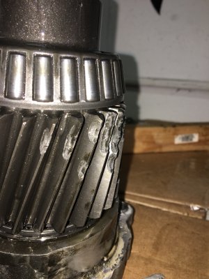

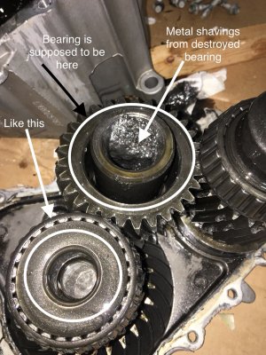

I can attest what carnage is possible from the dreaded gas smell of death.
Im currently swapping out my PTU.
In my case I think the bearing went bad causing the fluid to deteriorate.
No prior smells/issues it was all of a sudden.
