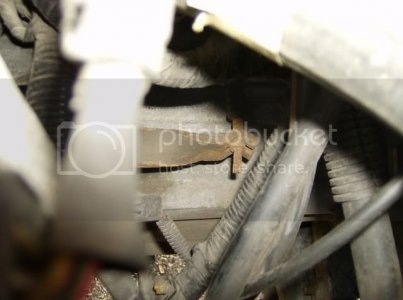

One other thing you can check is the tranny side of the clutch cable. Here's a pic from under the hood:
Clutchfork1
When you did your clutch and put that cable back between the tines in the clutch fork, how much extra were you able to pull out? Was it real easy to pull enough slack from the cable to put it back over the fork?
The EASIEST way to find out if your cable is streached is to temporarily shorten it and see if your problems go away.
Pull on the end of that cable and check to see how much room you can make between the fork and the detent on the cable. Find a nut that will barely fit in that space and cut a slot in the side of it the size of the cable end but smaller than the detent. This will take up most of the extra slack in the cable.
If this helps your issues, you DEFINATELY have a stretched cable. I certainly would not be pulling my trans until I KNEW the problem was not cable/pedal related.
As far as the padding goes I'm not sure that would even help. With even the carpet in I fully pressed the clutch pedal and it stopped short of touching anything I believe. If anything the arm of the pedal would hit the "mound" in the floorboard to the left of the pedal before the pedal itself actually touched anything.
Anyways, I think I'll look into temporarily shortening the clutch cable as you described. When I disconnected the clutch cable during the tranny removal it was very easy to get the cable detent out of the fork. I would assume that would be the case because I had the self-adjuster mechanism released (clutch pedal propped all the way up).

Took a look at the clutch cable to see how much slack I could get out of it. You are talking about slack by just pulling on it? If that's the case then the cable wouldn't budge at all. It's completely tensioned up.
