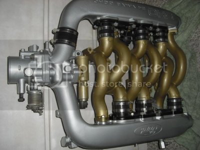

The EGR is on the rear surge tank of the intake manifold, plumbed in behind the throttle body. This is the cleanest picture of the area I could come up with during a quick search (not my intake, as it's way too clean):
CIMG1132
THERE----------------------------------------^
This intake is a non-EGR intake, but you can see the raised blank oval area cast into the intake at the bottom of this picture. On EGR intakes, this will have a (probably rusty looking) EGR valve bolted on. If you look at the underside of the casting on your car (once the intake is off) you'll be able to trace the EGR passage. At each point the passage makes a 90 degree turn there will be a plug threaded in. At the factory, they used long, straight drills, so there are a couple of turns. They merely screwed plugs in to seal the passages.
