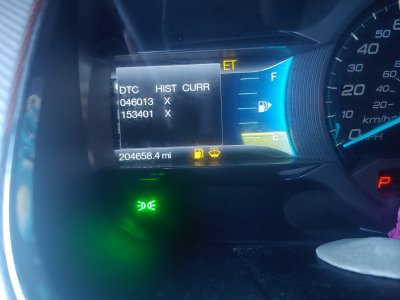

I know this is a.... late.... response but here are some codes from ETM.
