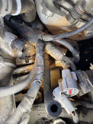

Yep i figured the intake was going to have to come off when i mangled the PCV hose getting it off. I am attempting to find a cooling system leak thats coming from the area under the throttle body. Ill attach a picture just for fun. I hate starting down the rabbit hole of wanting to replace the valve cover gaskets and all the other gaskets that are starting to leak. But I think ill hit one problem at a time at the moment. I have to find all the little s%$t the last owner did like using barsleak and replacing the coolant using water. If you look under the throttle body in the picture you can see all the rust being leaked all over the motor.
AAAHHH the joys of working on cars that arent on the easy part list.

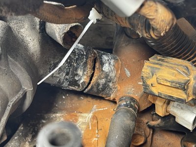

HOLY CRAP, why didn't any of you salty first gen SHO gurus tell me about the pain I was about to inflict upon myself trying to replace this one crappy 2" piece of hose. This hose blew between the two clamps holding it. Now im completely down the rabbit hole. Pulled the plug wires on the back side to get them out of my way and found them all half submerged in oil. At this point im going to have to just go ahead and do the 120K service. Its due.
Also, are there any sources to replace the heater hoses that are half metal? The rubber hose end of both of mine are about to blow. SHO Source is gonna make some money off me this week.

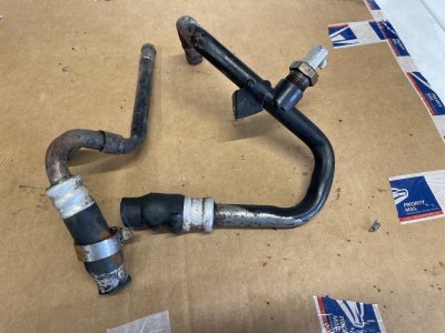

Carefully cut the clamps holding the the rubber hoses to the pipes and replace the hoses with new ones. Reuse the metal pipes. Regular worm drive clamps replace the original ones. There is a hose part number thread in the How To section. You can get them all via Rockauto, shosource, or the local parts store.
-Chad

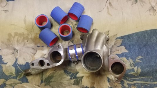

20190820 194535
20190820 194548

Dude, you brought a tear of happiness to my eye posting that picture for me! LOL
I owe you a beer one of these days!
Can you let me know where those replacement hoses you have in the picture came from. Also, does anyone have a nice replacement for these parts for sale? Mine are in pretty bad condition.

The hose sections are silicone replacements that I was offering for sale a while back. You can go to the parts store and get some fuel filler hose to replace the old section.
I'm sure I have a couple of the housings sitting on a shelf right now.
-Chad

Since im at it, I wanted to verify something. On the heater hoses is the standard replacement method to cut off the pressure hose from the metal tube and replace the hose with a reducing hose like the 18080 or the 18822?
