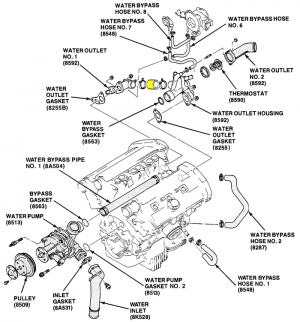

That hose is "a walk in the park" compared to the one I had spraying coolant through a pinhole, the yellow one below:
NumOnAj
Everything you see on that side of the engine has to come out including the two coolant block housings, replacing the above hose is done just because it is one of the things to take out to get it out of the way. You can't even see the hose that goes between the two heads.

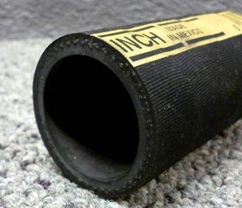

BTW, the hose between the two block outlets is 1.25", I replaced it with NAPA gold braid reinforced hose ($12/foot) and new hose clamps because I never want to do that again:

Stupid temp coolant manifold. It's the home of the temp sender and temp sensor, and also the thermostat. The pro tip is to not tighten the clamps down on that 3 in connecting hose until the manifold is on the engine.
