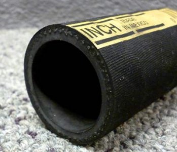

Just wanted to add an option for the 34 mm ID hose off the thermostat housing that needs to be about 2.5 inches long, AI let me track down Gates 21734 about $20 at Oreilly's. ID of the longest portion measures 34.1 mm ID.

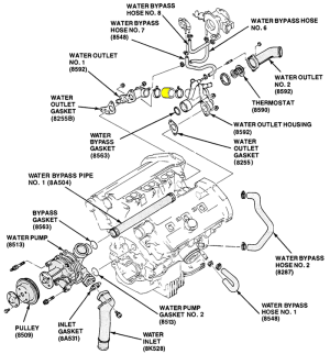

This is a great list, unfortunately not all are available overnight at Orielly's any longer. It would be great to match all these up with this diagram
SHO coolant hose diagram

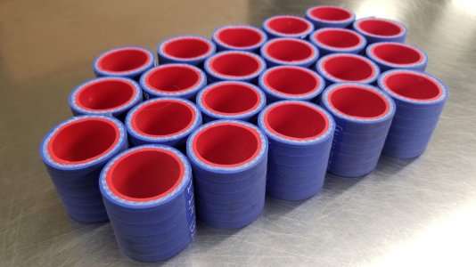

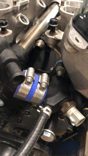

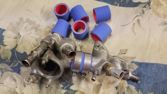

They are all available from Rockauto except for the upper rad hose. It's obsolete now. The one colored yellow in your pic is the one that I reproduce out of silicone hose.

I think Hose #8 in the diagram above is Gates 18020 which I got from Rockauto (Oreily's wanted $40). What matches up to Hose #7 ?
