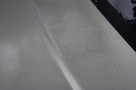

So I was wondering if there could be any hope with some TLC for this paint job:
Sho help paint
Things like what products, buffing compounds... etc might work would be helpful.

The bad news: There's nothing you can do to repair that damage. The clearcoat is cooked and coming off.
The good news: You can "fudge" it by wet-sanding all the faded clearcoat out, leaving the base coat and the remaining good clearcoat. You can then take a high-speed buffing wheel with a medium grit compound and buff the section back to a shine. The combination of a high-speed polisher and compound will blend the remaining clearcoat with the basecoat so it will look seamless and shiny. However, it will fade back out in a hurry, and if you want to keep it looking good you'll need to buff it probably once a month, and re-sand perhaps twice a year.
Also, dealing with wet-sanding and compounds with high-speed polishers can be a little dicey, as you can very easily take the paint right off your car. It's not a terribly difficult skill to learn, but patience and some experience are required to make it look really good. Fortunately, you already have damaged paint so it's not like you can make it look much worse :)

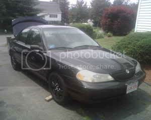

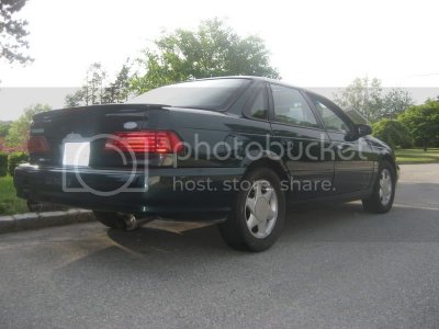

ryan21288
Sep 15, 2008
307
28
Rhode Island
It really is amazing what you can do with a buffer, compound and some good pads.
Before:
After:
IMG 2518
Before:
1221391g9ZZZZZZZZZ8ac2847b825ebd21e
After:
IMG 1362
