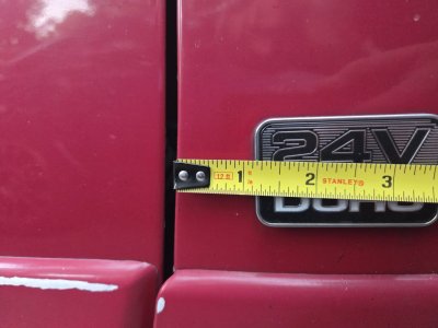

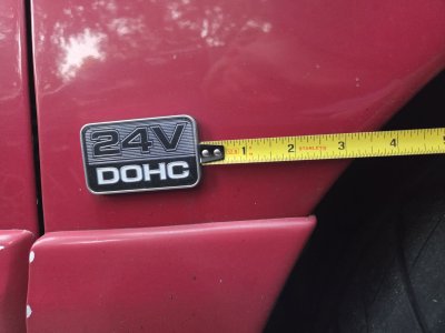

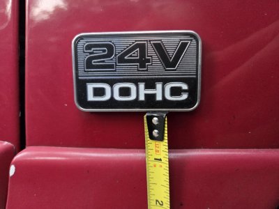

Real quick: Could any of ya'll snag me some precise locational measurements of the fender badges? Finishing some work tomorrow and wanna get these on before the wax.
Do you mean as to placement on the fender? If so I'll take some pics later when I get home.
