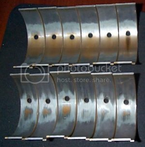

For some reason, rod bearing swaps seem to make people squeemish. As stated above, it's quite easy to do - especially if you have the y-pipe off for another reason(tranny swap).
Just follow the directions on shophoenix and plastigauge a couple of new bearings to make sure that they are going on an uncut crank.
The SHO crank is forged so grinding the crank is usually not needed.
My bearings looked like this and my oil light flickered at hot idle constantly. Now, my oil light stays off unless I lug the motor below 500RPM.
I measured the old bearings with plastigauge and they were right around .03 clearance.
With the new bearings, the measurement was right around .02 and no more oil light.
Notice that the wear is fairly even. If you see a very uneven wear pattern, you might consider grinding the crank.
