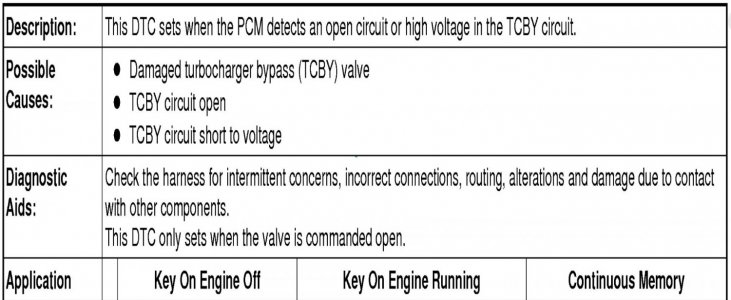

I just used a obd2 reader and got this code
P0035-00
Turbo/Super charger bypass valve control circuit high

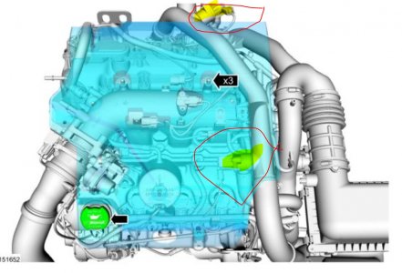

Check the Blow Off Valve - it might not be opening or fully closing the diaphram can go as well. Those are on top of the engine, one located by the firewall the other near the front of the car.
