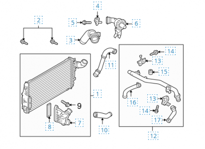

Point of order, rear turbo is the right turbo. Check the plastic pipe from the turbo to the intercooler for a crack or split. Check the rubber couplers for tears.

I stand corrected. The plastic "pipe" is one of the pipes that handles the boost from the turbos?

Yes, I believe numbers 11 and 12 in the picture. Check all the connections.
Cryptic Ford parts diagram:
