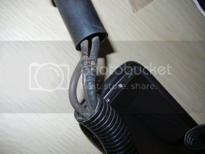

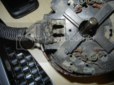

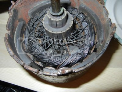

Blew my 50 amp rad fan fuse, so I went to the store and bought 2 more. fan kicked on and seemed to run fine. Figured I must of shorted something when I was working on it. Few days later sitting in the drive through and my car starts to overheat! Fuse blew again. Moral of the story, if a fuse blows, don't just replace it. Especially a 50 amp.
on a side note, when the SHO gets super hot and the temp gauge maxes out is it normal for the car to idle down drastically (to the point the oil light flickers?)

Don't know what to say, except for : that is good that it didn't get worse. I hope with fan replacement everything else would be the same.
