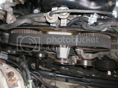

Removed the top timing belt cover and this is what I saw....I think I may have put the timing belt on backwards....
DSCN1004
DSCN1002
I still need to deal with the tensioner issue as well... it's still whining like a stuck pig.

Nope, you forgot the guide washer on the crank pulley.
Been there, done that.
Did it walk off the cam pulleys enough to eat into the timing covers?

I sure didn't forget the Washer.....I actually posted on here previously because I couldn't remember which way it went on. :bonk: It hasn't walked off enough to eat into the covers.
I know it's not that I forgot the washer.

You either forgot the washer, or put it on wrong.
There's no way that belt is that far off of the pulleys, and the washer is ok.

I'm thinking that not only the timing belt is on wrong but I have the tensioner on way too tight.
