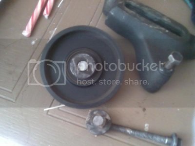

My old '92 made that sound until it broke this.... fan belt tensioner for the wp/ps.
