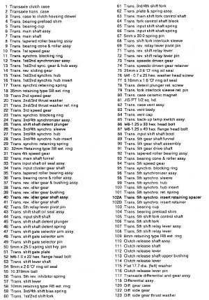

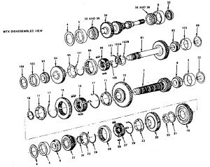

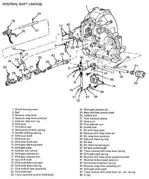

I'm in the same position as Chayes only my shifter wouldn't even move into the reverse slot. I got my tranny out last night and next Monday I'll be cracking it open to see what I did.
I found these on Autozone's web site, so I thought I would steal them from faceless, greedy corporate America but, you know, still give them credit.
TN20Internal20Shift20Linkage
http://www.abusivemotorsports.com/troy/SHO/Tranny/Internal Shift Linkage.jpg
TN20MTX V20Exploded20View
http://www.abusivemotorsports.com/troy/SHO/Tranny/MTX-V Exploded View.jpg
TN20MTX V20Gears
http://www.abusivemotorsports.com/troy/SHO/Tranny/MTX-V Gears.jpg
TN20MTX V20Parts20List
http://www.abusivemotorsports.com/troy/SHO/Tranny/MTX-V Parts List.jpg
