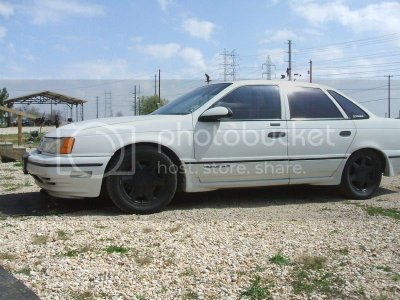

Here is a better pic of the car....
Fronts have 1.5 out and the rears have 1 out.
DSCF0398
I'd like the front to be a bit lower.... but ****, as it sits i still need to drive the car up on piece's of wood to clear the jack... :nut:
