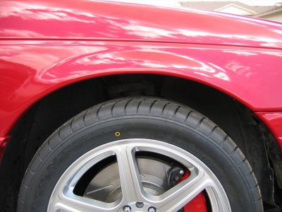

well i have a nice pair of 18's on there and i wanna close the huge gap between the fender and the tire, its got low profile tires, so right now it looks horrid, but i also wanna tighten up the ride , its a bit loose up front and kind bouncey, nd i wanna a suspension thats gunna handle well at higher speeds... although she handled really well at 130mph on the mass pike when i was home :)

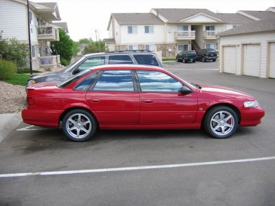

Here is Intrax/Koni (1 coil cut up front) look on 235/45/17. The ride is firm, but tolerable.
26748934052 large
26748934004 large
The driver's side sits slightly higher than the passenger... But most of the weight is on the passenger side. I'm annoyed with it, so I'm getting in on the coilover group buy.

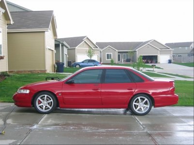

Here is Eibach/Koni on the same wheels/tires:
26748934054 large
26748934056 large

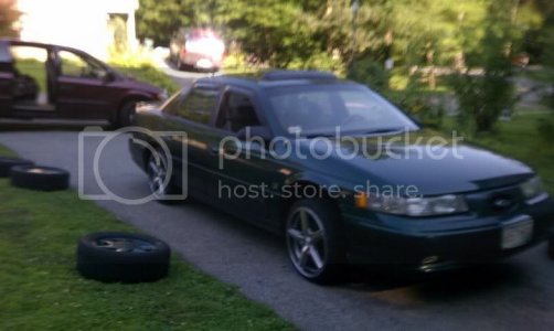

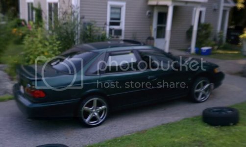

hmm not sure about the whole PM thing, but also i want my car to be like wtf low like the tire is almost inside the wheel well.... i hope the picture i put up this time is big enough, how much of the spring do you think im gunna have to / shud have it cut to achieve the low look im seeking, id try for the koni's id think but it doesnt say if they come with four struts in it it jus says 89 thru 92 rears are out of stock, im gunna shoot them an email see what up but i tihnk im gunna go with the sensa tracs... my most inportant thing is that my car gets low enough to where they rim/tire combo looks good but i dont sacrifice so much stiffness that i might as well say f it........ also would a strut bar in the front be a swell investment with all this as well?

im pretty sure one of those pictures isnt supposed to be there so just in case..
