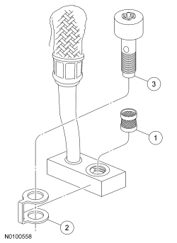

when the turbos got changed did you inspect or replace the screens in the end of the oil feed line to make sure they didn't get plugged?

I do not know for sure,,, they were suppose to clean them cuz they could not get new lines.

The oil screen is not part of the line. It is a separate part that goes in the banjo fitting of the oil line. Oil supply line filter AA5Z-6C683-A
A new one should be installed when changing a turbo.
Thanks so much.. This looks like it could be a a cause for sure. And I am sure they did not replace it cuz i did not get charged for it.
Thank you! I remembered seeing this post when I was taking my turbos off. Those filters were plugged up. I was looking on Tasca and that part is not called out anywhere. Even when I put that part number in, it does not show an application. I added a pair to my parts order. $15 is some nice insurance to make sure the turbos are well-fed.
