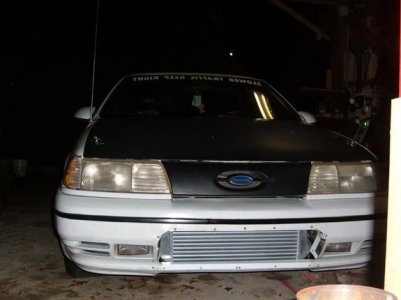

Got the tuning figured out nd now boosts like at least twice as fast. also here are some recent pics.
Downpipe (dont mind the messy/****** welds on the ****** theres good welds underneath just wanted to patch a few spots up)
car
Left-Buddies Chipped modded GTI with about 240 WHP on the 1.8T (tq monster) Mid some *** with a turbo taurus... who does that anyways? Right- Other buddy with his turbo MR2 CF hood and Blue primer :p

im too embarrased to post any more engine bay pics.. its so ******* messy and hackjob looking... it all functiuons properly but give me a month and i should have enough money/time to do some things properly that are really bothering me.
thanks
-M
Rubix
Jan 12, 2005
1,329
858
Aww cmon, it's gotta look better than that hackjob bumper :biggrin: Sounds like she's comin' along nicely, everything looks great in that picture third from the bottom in post #35 :thumb:
