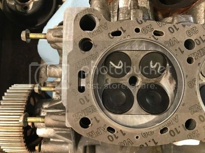

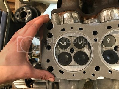

Here are a few details on the lovely SHO source ARP head studs and cometic 3.2L gasket.
To start, note that the gaskets are not symmetrical. If you place them upside down, you will port a cooling passage into an oil passage!
Correct:
747D7B8D FD71 42E9 8A99 D7E872CDCAB6 zpsuwh7qwte
Incorrect:
F27FC23C 2766 4BD5 B8E2 4012C543B939 zpsg84s9ngl

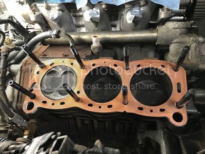

The studs are pretty straightforward.
You can install the studs first then drop the head on or the head first and then place the studs in. In either case, normal practice is to bottom the studs, then loosen them 1/8 of a turn. They should be loose.

Other than that, i followed the stock torque sequence and used the following torque stages:
1) torque all to 35ft-lbs
2) torque all to 50ft-lbs
3) torque all to 65ft-lbs
4) torque all to 80ft-lbs
These torque values are with ARP moly ****! This is the recommended thread ****.
I chose 80ft lbs for two reasons. First,
My engine builder/mahinist recommended 75-85ft-lbs based on the diameter and length.
Second, the 2JZ guys (which use a similiar length stud with same M11 thread) use 80ft-lbs and thats the ARP recommendation for that motor.

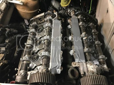

Now to finish up the timing belt, fuel rails, and intake. Thanks again SHO source for these great products.

That victor Reinz in the top photo looks like oem material. You can buy that brand at NAPA and other places. The Cometic at the bottom looks different. Maybe I'm wrong...
Shamwow
Apr 7, 2013
38
48
Michigan
There are three gasket pictures, all of the same cometic gaskets from SHO source. They came in Cometic packaging from Cometics address.
You can see that cometic appears to manufacture the gaskets from victor reinz material. Or perhaps subcontracts VR to produce them. Victor Reinz is generally good stuff in my experience in the Nissan world.
The installed picture is the same gasket coated with copper spray. Its probably not necessary but old habits die hard.

I've always bottomed out head studs. ARP says to do this as well. http://arp-bolts.com/p/FAQ.php
I personally would have gone to 90-95 ft-lbs. They used to specify 80 for the Subarus and found it not to be enough and that block and have revised... and is nowhere near as strong as the SHO block. I am curious to see what these will do in Zach's motor as it will be pushing more power than any SHO, ever.
Shamwow
Apr 7, 2013
38
48
Michigan
I thought about doing a bit more torque but i didnt want to warp the head. We will see how they hold up!
