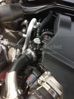

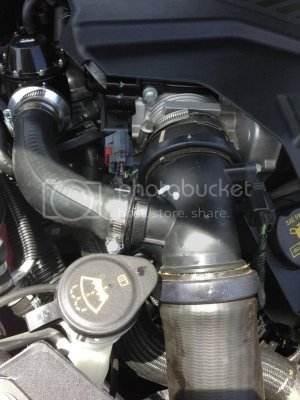

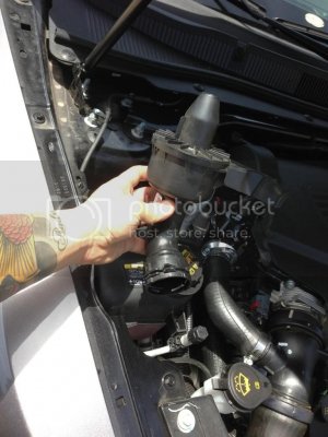

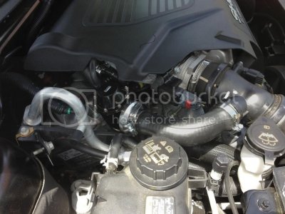

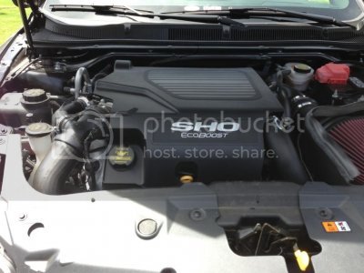

Sorry I'm kind of reviving an old thread but I wanted to add a bit more detail and pictures to the install, I did it today and its pretty easy. Having the exact parts helps tremendously! I included my O'Reilly receipt with everything I got for the install. As another member mentioned sanding down the intake tube where you connect the radiator hose is a must, without that the tube will come off. I went back and trimmed off the unused length on the hose clamps with a hose clamp cutter (I had to borrow one).
