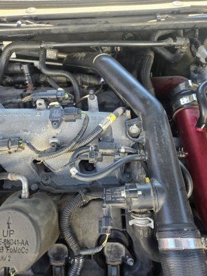

There's a vacuum control valve on the front of the motor in plain sight, it should have three hoses coming off of it. Check to see if the little rubber vacuum hose has come off or sprung a leak. Mine got loosey goosey and I put a fuel hose clamp on it. When mine came off it would seem like any boost was just getting vented and the motor turned anemic.

This fella here on top of the motor, under the beauty cover.

Popped the cover off and sure enough the hose going into the boost hose had fallen off. Thank you very much for the help!
You betcha. I'd put a hose clamp on it if it doesn't already have one. Mine was stretched from age.
