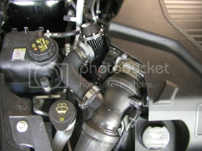

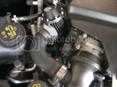

Looks like a BOV near throttle body.
What did you do to block off the factory bov? If you didn't block it off then the HKS will be much more quiet...since your venting off to two sources now. At least thats how it works in my SRT-4 and I'm sure the same applies here.
