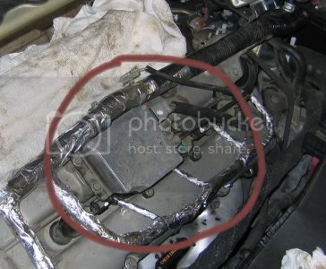

Looks like just aluminium foil to keep heat off the leads. Assuming you were talking about in the photo. If you are talking about tie wraps to wire down the actuating arm, just standard heavy duty ones, the ones that are 5mm (3/8") across.

JSIL1 said:
What type of wrapping are you using?
It's some hi temp aluminum tape basically. It looks basically like aluminum foil but had a sticky tape backing to it. We use it at the fiberglass door factory when a door is made that is going to be used in a freezer. A HOT wire runs around the door frame and this keeps the seal of the door and frame from freezing together.
I recentlly took the vanity cover off to check things out and everything was A-ok. It's going to have to get hotter than the plastic to melt the harness now.
