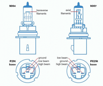

No, the stock bulb (in a Gen2) is a 9007 which has high beams and low beams in one unit, so no luck there. As a side note, Gen1's use 9004 bulbs, same shape connector, different bulb pinout & filament orientation.
However, if you really want to totally remove your high beams, you can cut/remove the wire that feeds current to the high beam filament in the bulb. Here's the pinout so you know which wire:
9004vs9007
Obviously, you'll want to refer to the bulb on the right (the 9007), and ignore the bulb on the left (the 9004).
Good luck.

This turned out to be the quickest and most effective solution. All works great. no more DRL!
