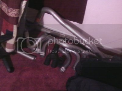

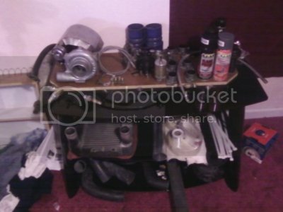

Wow that's just about everything in my room! :nut:

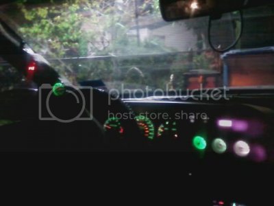

And I've got my gauges mounted already. WB02, Vac/boost, Oil temp, Oil Pressure, Water temp, volts. I don't really see the need for a tranny temp gauge unless you have a quaife. But OTOH, the more info the better.

Is that an IC off a probe? i wonder how well they flow... prob not enough for my 15 psi build :( i like cheap intercoolers with in-out on one side

Yeah. I don't see the need for tweecer yet. Plus that FMU is not your average run of the mill FMU. http://www.cartech.net/fmu2020instruc.htm
Yeah it is. Should do well in my setup.
