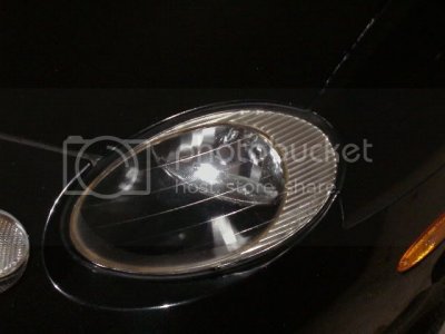

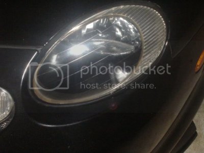

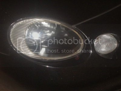

HOW THEY LOOK anyone know how this was done?headlights

Those were tinted a little too dark. I put 3 coats on them and should have stopped at 2. They can tint the clear any shade you want. I would start with 30 grams of black for 1 pint of clear thats what I use now and 2 coats work great.

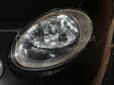

Anyway, I was going to try this mod but my lights must be different because mine don't just unbolt and come apart. There are (4) 7mm bolts on the back that connect the black and gray sections together, remove those and there is what looks to be ****** shaped black plastic melted/fused into the gray part right beside the 7mm bolt holes. I would guess that to do this mod you would just need to remove the clear cover part right? I see 2 small nut like fasteners on the top of the light and a clip like fastener at the bottom that has melted/fused gray plastic on it and it looks like the clear part is sealed or glued to the gray part.
Does this sound like what you saw when you took your apart???

You can paint the silver fluted part without taking the lights apart. The inside of the lights, the housings, must be taken apart to be painted, obviously.

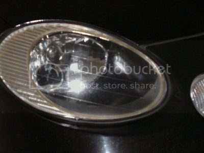

I see now that I am looking at the posted pictures backwards. When looking at the first few pics, you are looking from the back, (like you are the light bulb), and it is the clear part that is masked off. You didn't have to remove the clear part, just remove the reflector part and tape off the clear inside. Duhhhhh I am a little slow sometimes but I get it now.

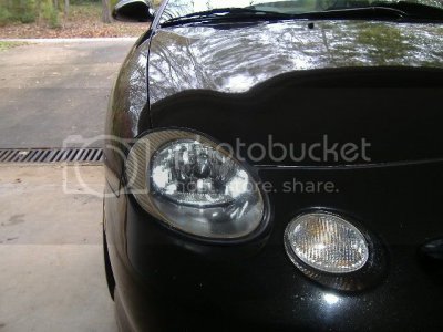

I did this mod the other day. I used a small drill bit and drilled out the plastic ******* that are beside the 7mm screws, stuck a long narrow punch into the holes and tapped the two peices apart. I masked off the inside of the clear lens with masking tape and sprayed a nice even coat of primer followed by 2 to 3 coats of Krylon satin black. After I carefully removed the tape, I put some rubbing alcohol on a cotton ball and cleaned the inside of the lens to make sure that no tape residue was left and made sure that the whole thing was dry before re-assembly. I like the finished look of this mod and being that my car is black, it looks like the light housings are actually part of the body of the car. Kinda reminds me of the series 1 Jaguar E-Type lights and how the light was set back in a cove and was covered.

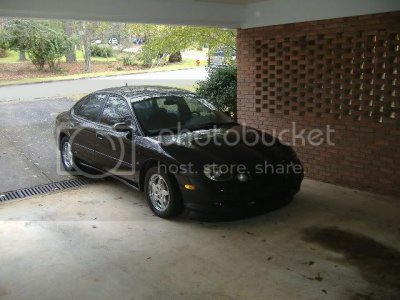

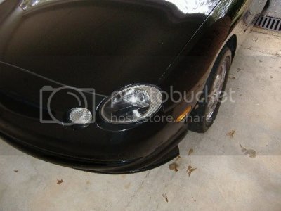

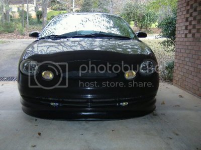

Pics of Headlight Mod
HeadLights043 HeadLights039 HeadLights041 HeadLights040 HeadLights042 HeadLights038 HeadLights037 HeadLights036 HeadLights035 HeadLights034
It was overcast today so these pictures are somewhat dark but you get the idea. The oil stains in the parking spot are not from my car by the way, and you can see the steepness of the transition from the short driveway to the carport. I put my air dam back on and it scrapes alot but oh well, it is lawn edging.

they do look good but i still think the outside should be painted you have that yellow ring that stands out thats the main reason i did mine

Yeah, it doesn't bother me that much, I just wanted the insides to be black. However, I just picked up 2 cans of Nite Shades and some clear coat for the tails and markers. I may have to look at masking off the headlight lens and spraying the eyebrow and edges with Nite shades.
